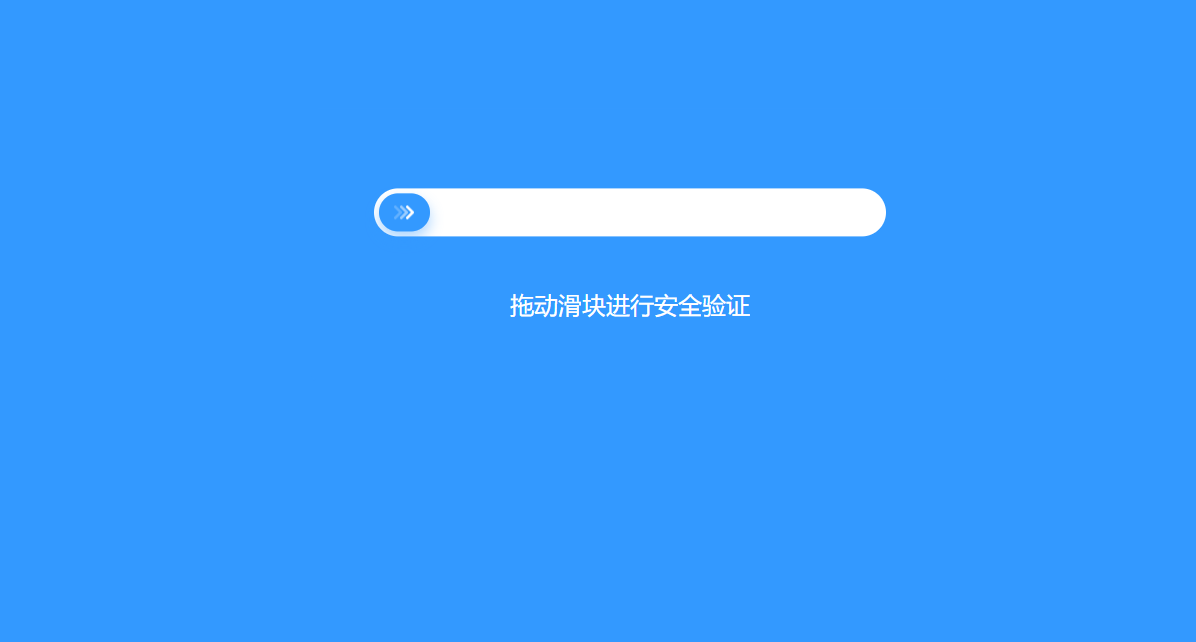

PHP防火墙代码,防火墙,网站防火墙,WAF防火墙,PHP防火墙大全
PHP防火墙(作者:悠悠楠杉)
验证测试,链接后面加上?verify_cs=1后可以自行测试
文章来源:https://blog.csdn.net/u012241616/article/details/147191684

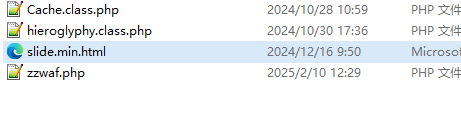

```<?php
//复制保存zzwaf.php

include(‘Cache.class.php’);
$cache = new Cache($_SERVER[‘DOCUMENT_ROOT’].‘/cache’);

if(!empty($_GET[‘verify_cs’])){// 用户验证测试
$verify = true;
// 访问量过大用户验证
if($verify){
http_response_code(444);
include ‘hieroglyphy.class.php’;
$addsalt = md5(uniqid().time());
$cache->set($addsalt,time(),60);
$x = new hieroglyphy();
$addsalt_js = $x->hieroglyphyString($addsalt);
$ip_ceiling = false;
$cookie_hashsalt = !empty($_COOKIE[‘hashsalt’]) ? $_COOKIE[‘hashsalt’] : ‘’;
// echo $cookie_hashsalt;exit;
if($cache->get($cookie_hashsalt) === ‘ok’){
$ceiling = $cache->get($cookie_hashsalt.‘_ceiling’);
// echo $ceiling;exit;
if(substr_count($ceiling,‘,’) <= $visits){
if(strpos($ceiling,$realip) === false){
$ceiling .= $realip.‘,’;
$cache->set($cookie_hashsalt.‘_ceiling’,$ceiling,60);
}else{
$ip_ceiling = true;
if($cache->get($cookie_hashsalt) !== ‘ok’ || $ip_ceiling){
include ‘slide.min.html’;exit;

其他文件
`<?php
//复制保存hieroglyphy.class.php

大楷截图
Image description![Image description](https://s.rmimg.com/2025-04-22/1745307220-945259-image.png)
测试截图:
Image description![Image description](https://s.rmimg.com/2025-04-22/1745307228-793707-image.png)
